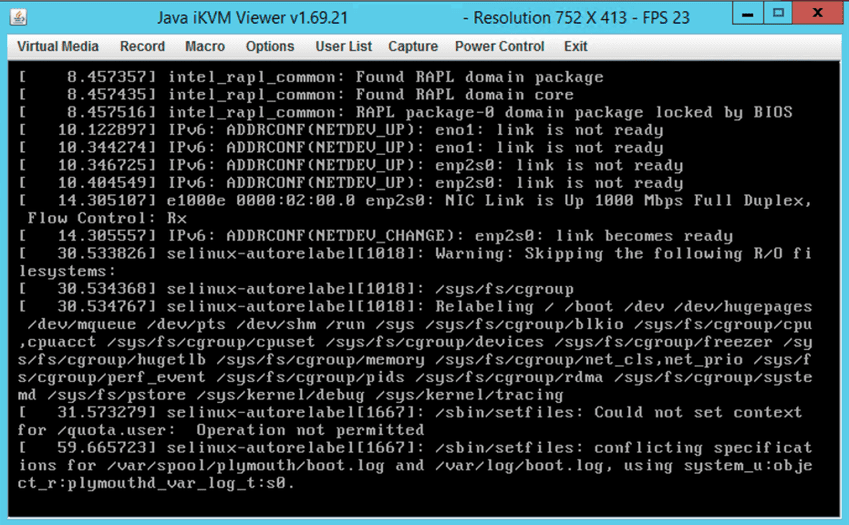

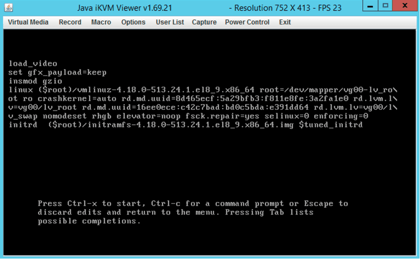

Stuck at SELinux Auto-Relabel (Stage 4 Post-Reboot)
When: After reboot into the upgrade kernel during Stage 4 of 5.
Error: The boot process gets stuck at the section where selinux does the autorelabel.
Solution:
# Restart the server with CTRL+ALT+DEL (not a reset)
# In GRUB, add the following as you would normally add the FSCK stuff
selinux=0 enforcing=0
# This will force a skip of the selinux autorelabel actions
# Check the --log if the upgrade is continuing
