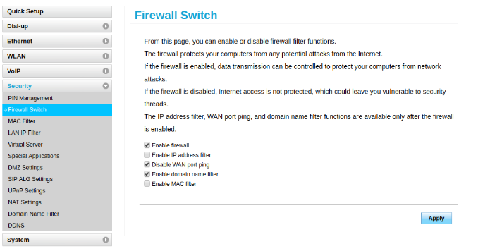

  • Log into the router.
  • Go to the Firewall Switch option under the Security section.
  • Select the ‘Enable domain name filter’ tick box and click ‘Apply’.

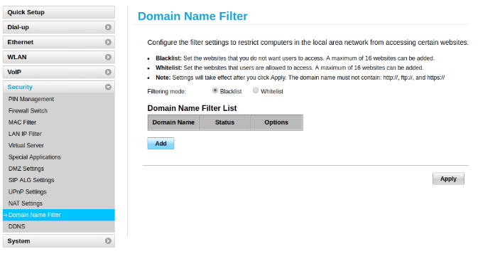

  • Now click on ‘Domain Name Filter’ under the Security section.
  • Click on the ‘Add’ button to block a new website.

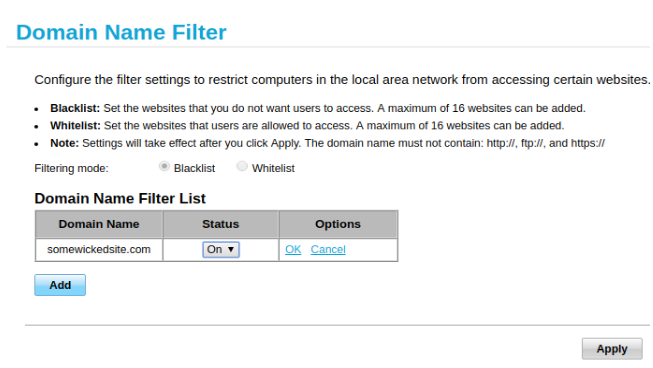

  • Enter the domain/website name you wish to block.
  • Set the status to ‘On’.

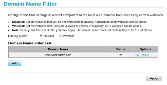

  • Under the Options column, click ‘OK’.
  • Click on the ‘Apply’ button to confirm your settings.
  • The filter has been set, the website has been blocked.
