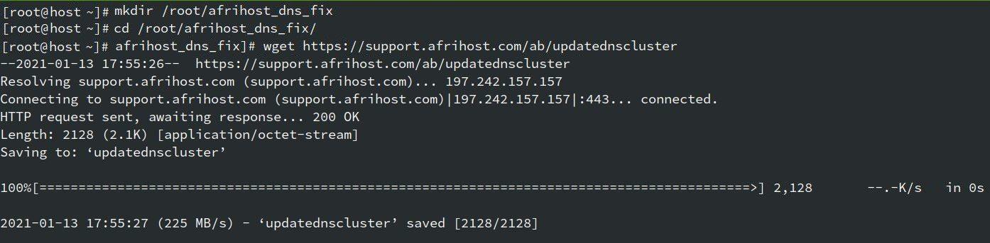

1. Use the ‘wget’ command to download the script (https://support.afrihost.com/ab/updatednscluster) to your preferred directory on the server.
[root@server_name ~] # wget https://support.afrihost.com/ab/updatednscluster

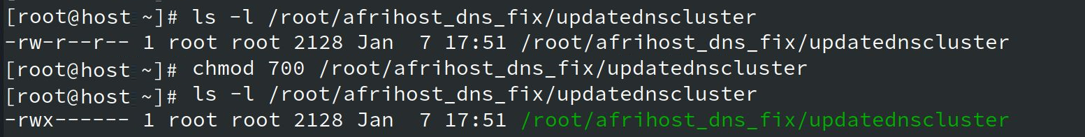

2. Make the downloaded file executable.
[root@server_name ~] # chmod 700 /path_to_downloaded_file/file_name
TIP:
You can enter the command ‘ls -l’ to check if the file is executable.
The downloaded file needs to be run with root privileges.
3. Run the file. Ensure you use the correct file location.
[root@server_name ~] # /path_to_downloaded_file/file_name/updatednscluster

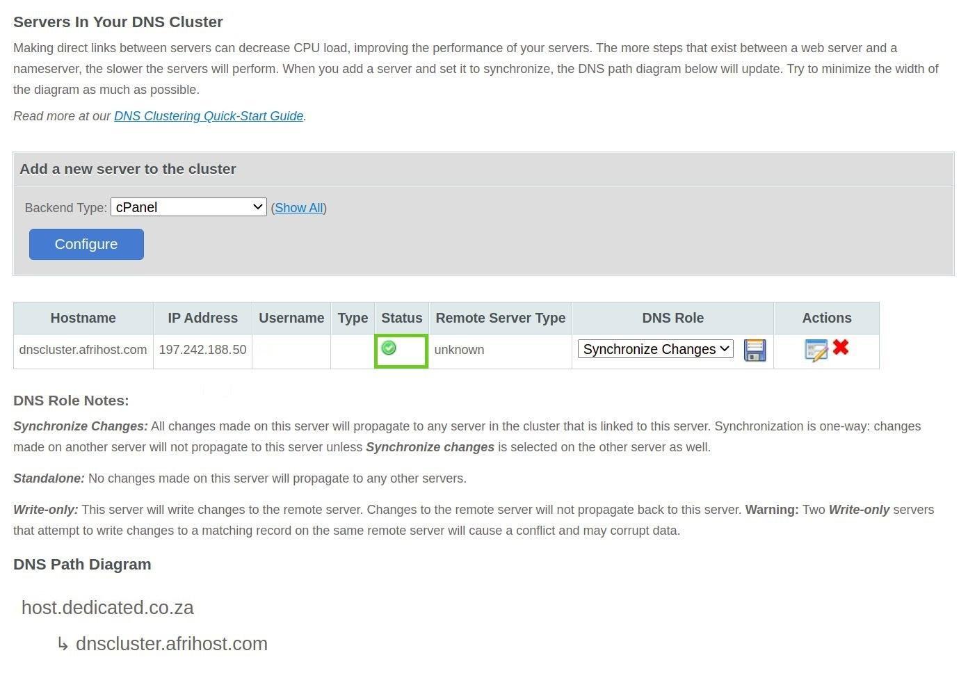

4. To confirm that the fix is in place, this can be viewed in WHM (Web Host Manager).
Go to WHM > DNS Cluster
If a green tick is showing under ‘Status’, the fix has been successful.
