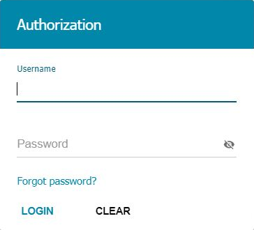

  • This will take you to the D-Link login page. Log into the router with the username and password.
  • Click ‘Login’.

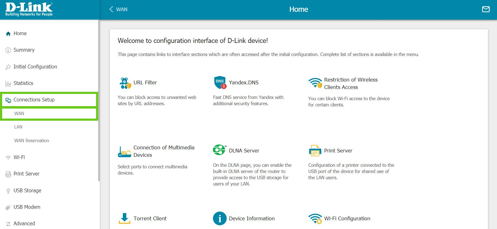

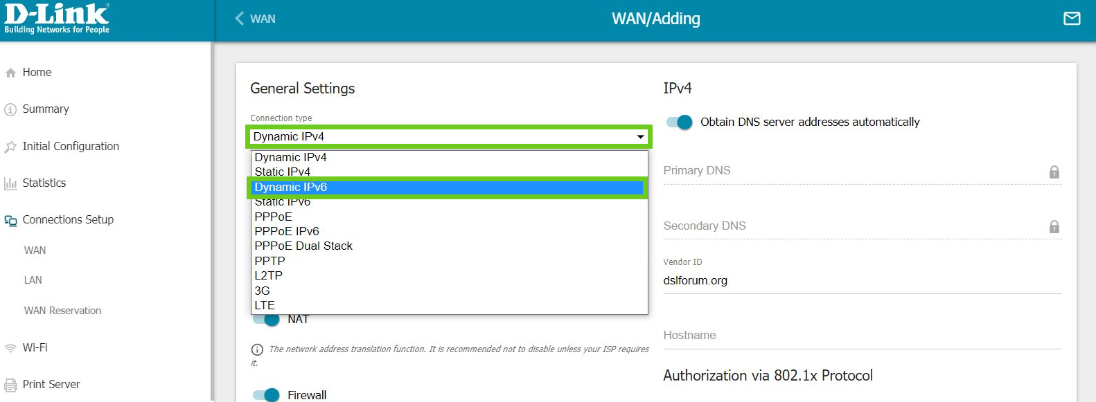

  • This will open the router’s dashboard. Select ‘Connection Setup’ on the left and then select ‘WAN’ below that.

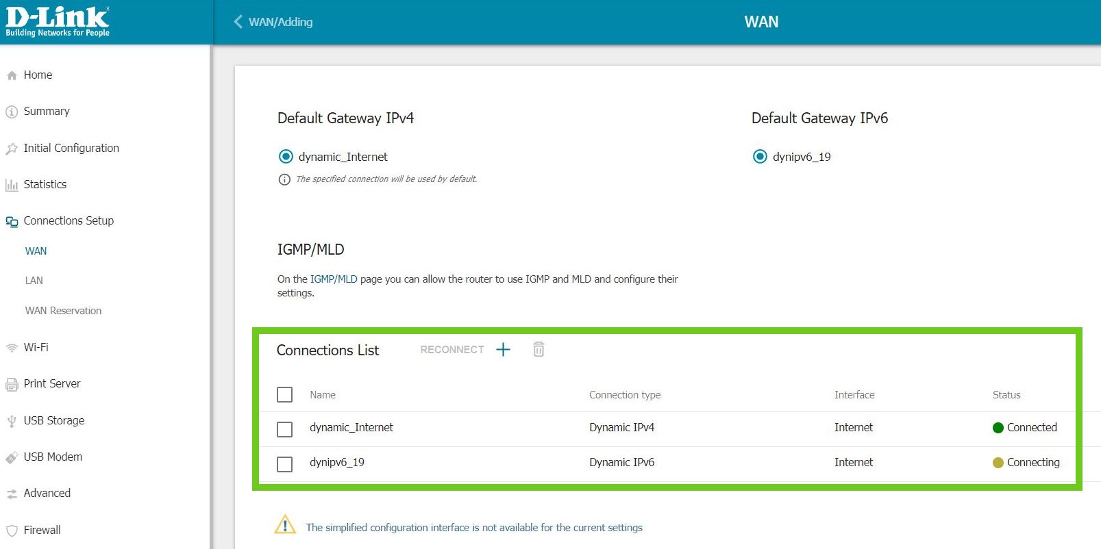

  • Here you will see the current connection types in the Connections List.
  • Select the ‘+’ button to add a new connection.
Do not remove IPv4.
You need both IPv4 and IPv6 connections enabled.

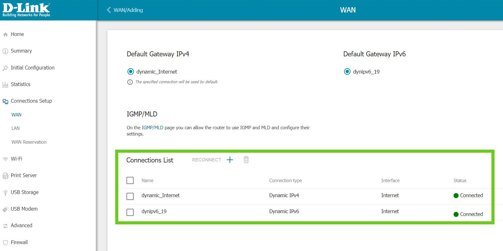

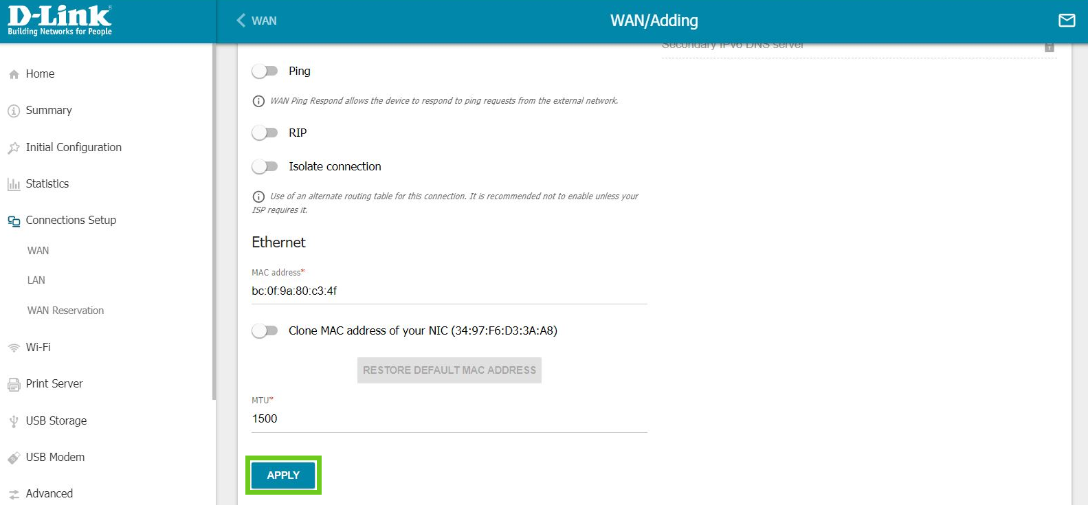

  • In General Settings, under Connection Type, from the drop-down list select ‘Dynamic IPv6’.
  • Scroll down, change nothing else and click ‘Apply’.
  • In the Connection List, you will see that Dynamic IPv6 has been added.

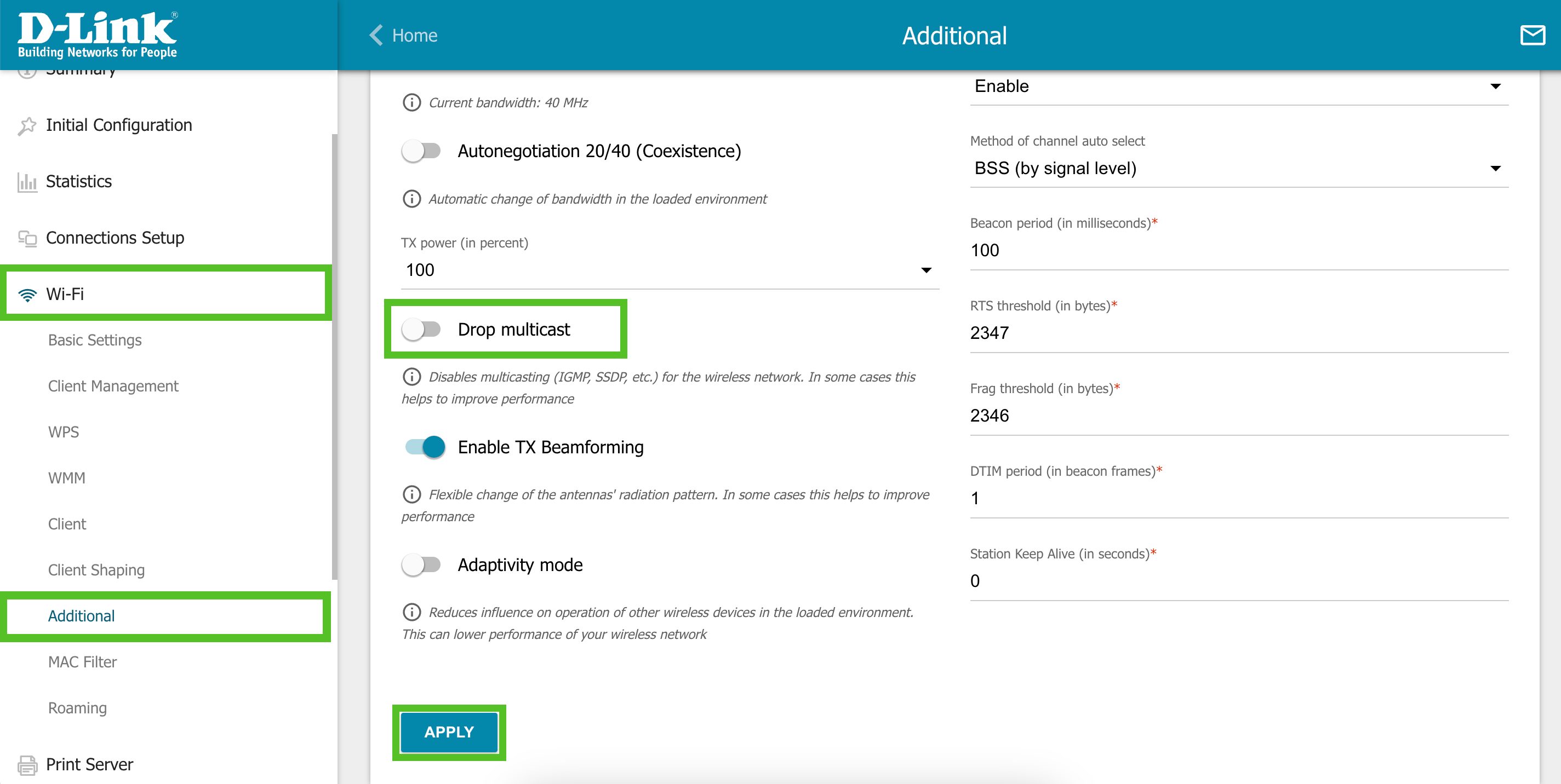

Follow these steps if your 2.4GHz band fails to establish an IPv6 connection
  • Go to the menu on the left and find 'WiFi'.
  • Select 'Additional'.
  • Within the 2.4GHz additional settings, disable the 'Drop- multicast' toggle.
  • Scroll down and click the 'Apply' button.
