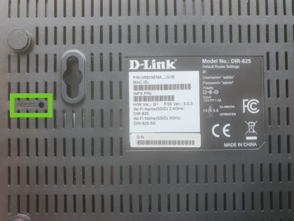

2. Reset the Router
  • Using a pin, reset the second router to factory settings, press and hold the ‘RESET’ button located underneath the second router for approximately 15 seconds to reset it to factory settings.
  • Wait until the lights on the device stabilise.

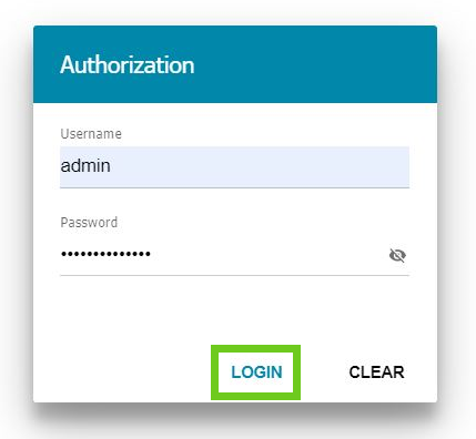

  • Log into the router with the device's username and password:
  • Username: ‘admin’
  • Password: Enter the default password displayed on the sticker under the router.

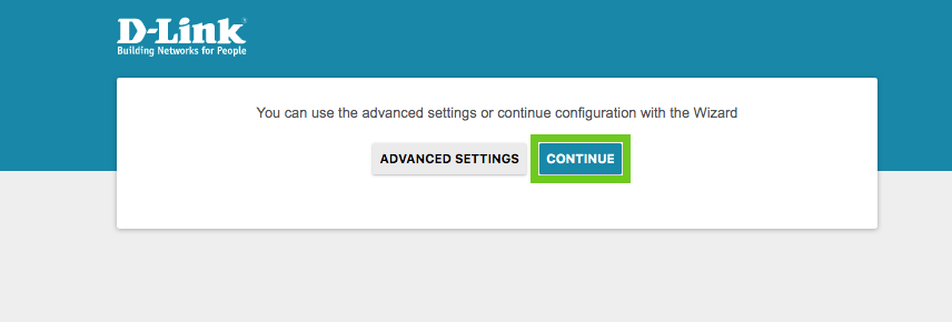

  • Click ‘Start’ to start the ‘Internet Connection Setup Wizard’.
  • Select ‘Continue’ to configure via the Setup Wizard.

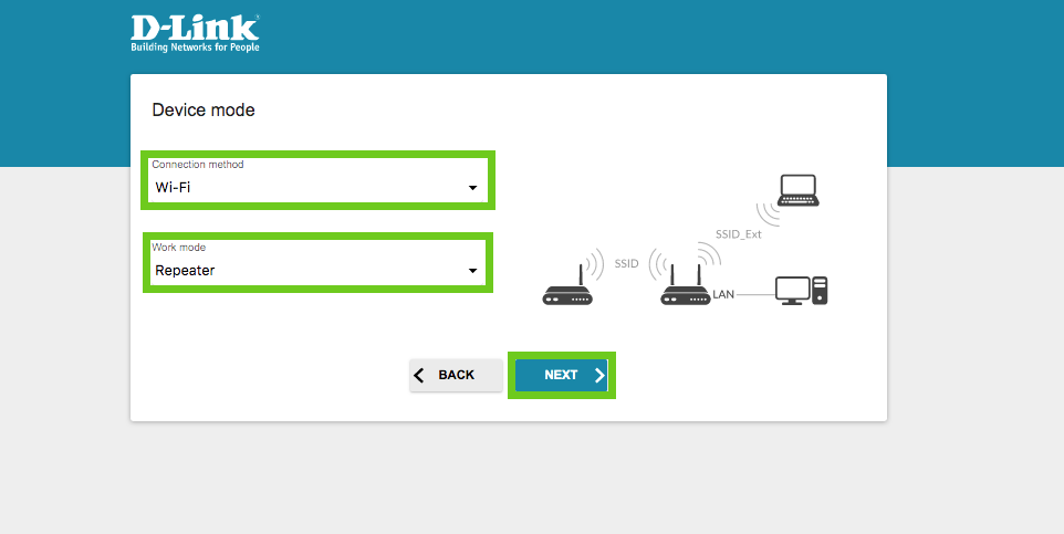

  • In the Connection method drop-down menu, select ‘Wi-Fi’.
  • In the Work mode drop-down menu, select ‘Repeater’.
  • Click ‘Next’.

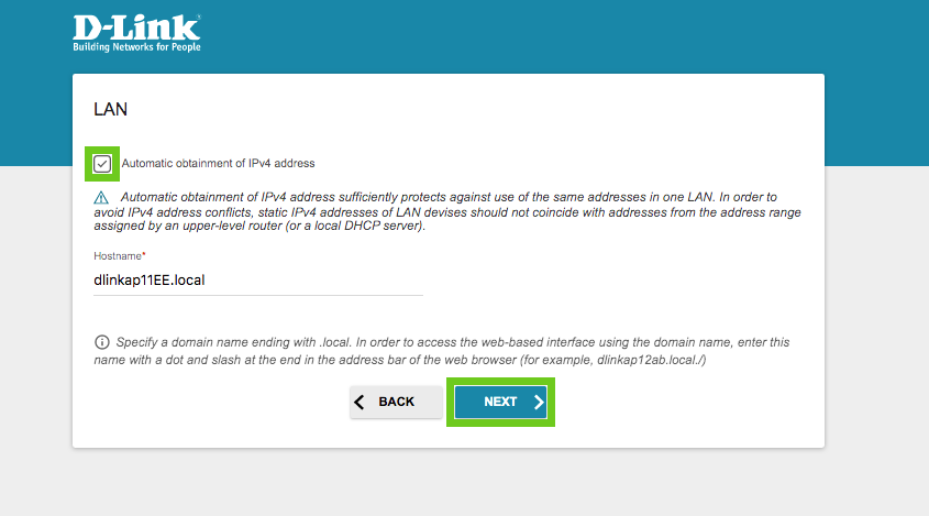

  • On the LAN page, tick ‘Automatic obtainment of IPV4 address ‘.
  • Click ‘Next’.

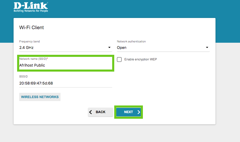

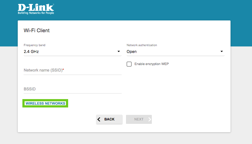

  • On the Wi-Fi Client page, select ‘Wireless networks’ at the bottom of the page.
  • Select the Network Name (SSID) you want to repeat.
    You may be required to enter the password.
  • Click ‘Next’ to create the Wi-Fi Repeater profile.

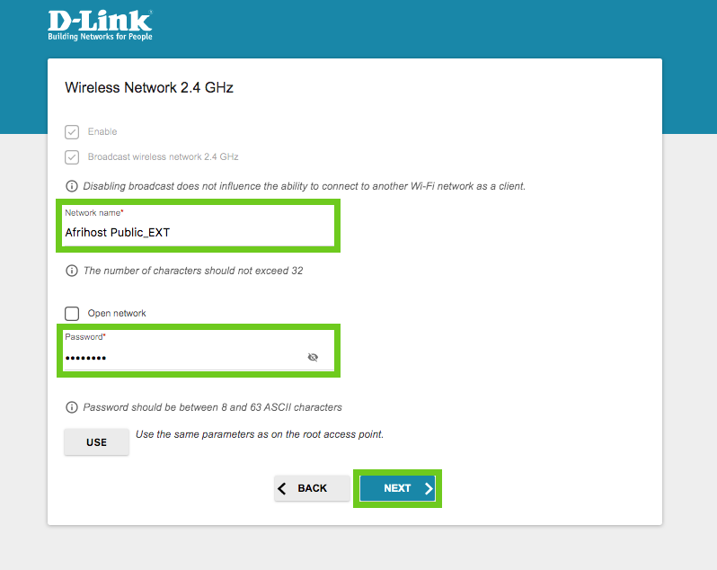

  • The new network name will be the original name with _EXT added to the end.
  • Create the password for the repeater. You can also select ‘USE’ to copy the same access details from the main router.
  • Click ‘Next’.

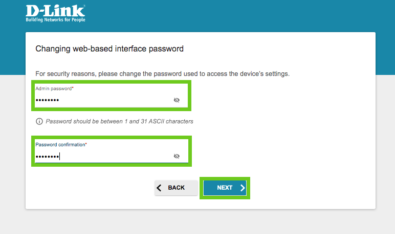

  • For security purposes, you will be requested to update the router login details on the Change web-based interface password page.
  • Click ‘Next’.

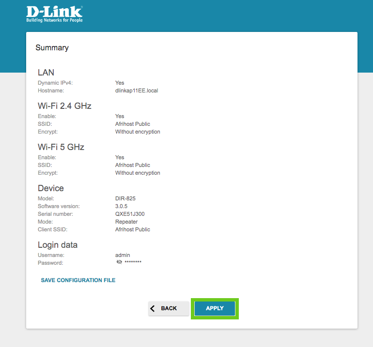

  • A summary of your changes will appear, Click ‘Apply’ to save these settings.
Create a secure password.

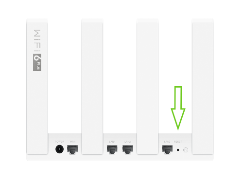

2. Reset the Router
  • Reset the second router to factory settings. Using a pin, reset the second router to factory settings, press and hold the ‘RESET’ button located underneath the second router for approximately 15 seconds to reset it to factory settings.
  • The router will restart, the light indicator will turn red, and the router will be restored to the factory settings.

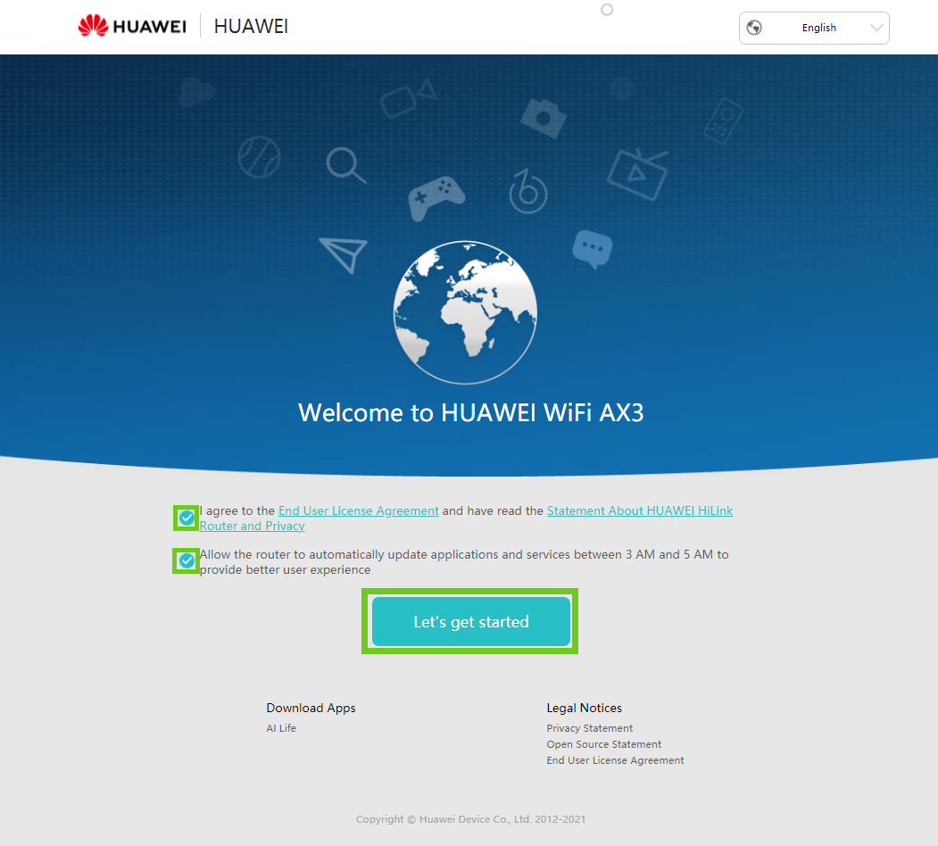

  • A welcome screen will appear.
  • Tick the box to accept the End User License Agreement.
  • Tick the box to allow the Automatic Updates.

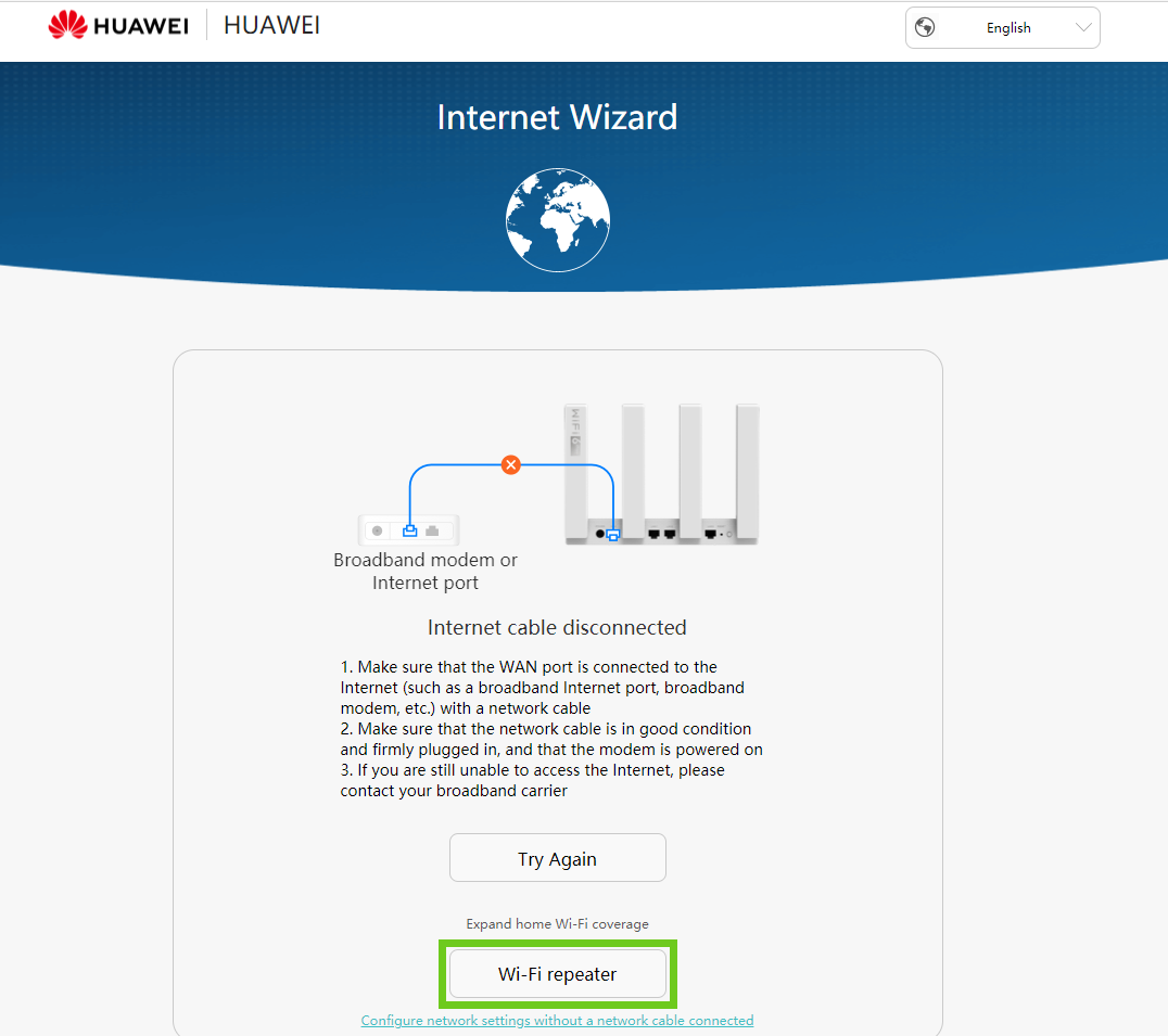

  • Select ‘Let’s get started'.

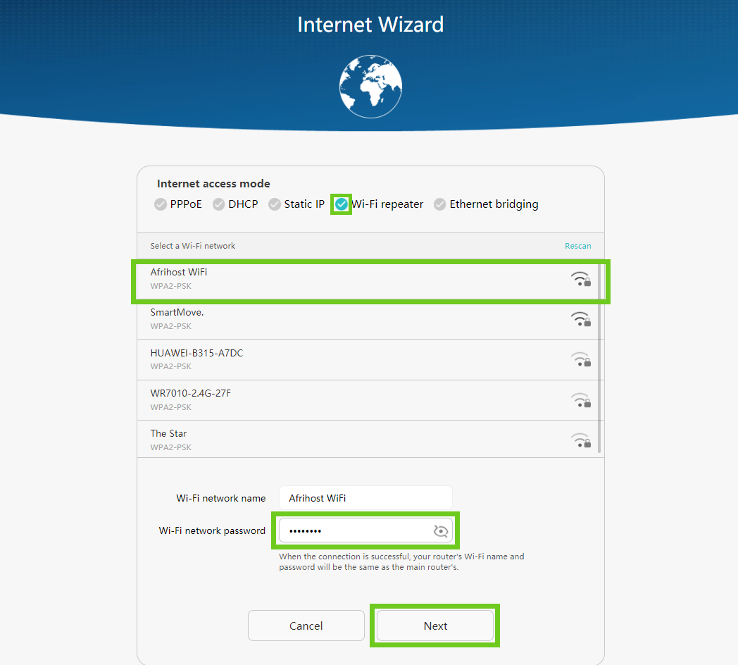

  • Select ‘Wi-Fi repeater’ to extend the coverage.
  • Select a WiFi network that you wish to repeat/extend from the list of available WiFi networks.
  • You will be prompted to enter the ‘WiFi network password’. Enter the WiFi password of the WiFi network that you are repeating/extending.
  • Select ‘Next’.

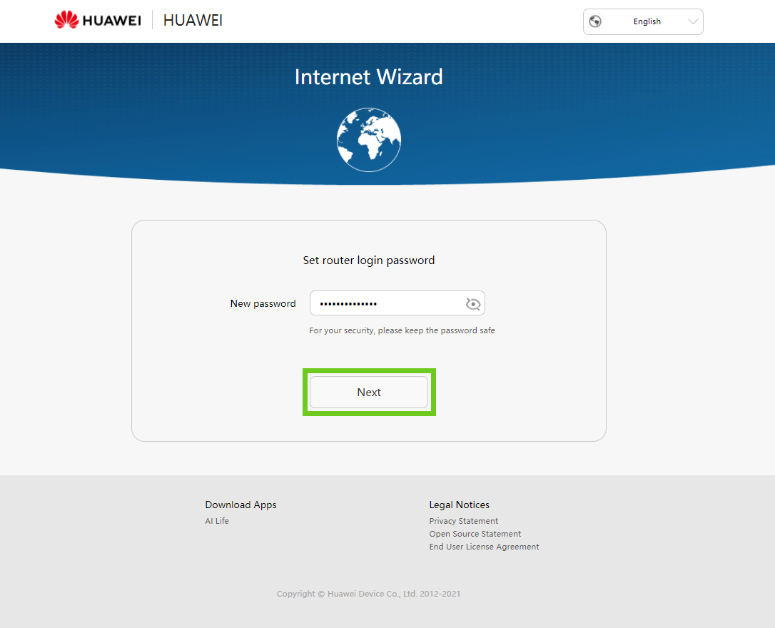

  • Enter your desired Admin password. This is the admin password used to access the router’s user interface (UI) configuration page.
  • Select ‘Next’.

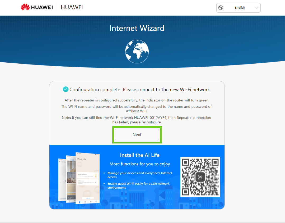

The configuration is now complete!
  • At this stage, the front light indicator should be steady green which indicates that the router is now connected to the internet and working in ‘Repeater mode’.
  • Select ‘Next’.
  • If you are connected via WiFi you will need to reconnect to the router's WiFi network to access the internet.
Please Note!
The WiFi name and password of the HUAWEI WiFi should be the same as the WiFi network that you are repeating or extending. If it is not the same, it means the repeater’s configuration failed and you will need to reset and reconfigure again following the same steps.
