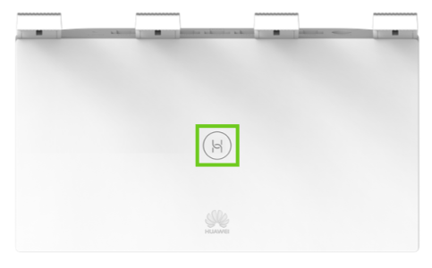

Method 1: Wireless connection by touching the ‘H’ button
  • Place the second router near the main router, recommended within 1 meter and connect the second router to the power supply.
If your secondary Huawei/any WiFi mesh supported router was previously configured, please reset it to the factory default settings.
Once both routers are powered up:
  • Wait approximately 1 minute until the indicator of the main router slowly flashes.
  • Then press and release the ‘H button’ on top of both routers. This will allow the devices to scan and pair with each other.
  • The indicator will flash faster. When the indicator of the secondary router remains steady green, it indicates that the connection is successful.
  • Once the connection is successful, the WiFi name and password of the secondary router will be the same as those of the main router.

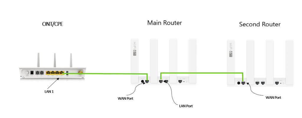

Method 2: Wired connection
  • Connect an ethernet cable from a LAN port on the main router to the WAN port of the secondary router.
  • Then press and release the ‘H button’, found on top of both routers.
