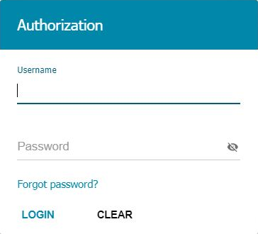

  • This will take you to the D-Link log in page. Log into the router with your username and password.
  • Click ‘Login’.

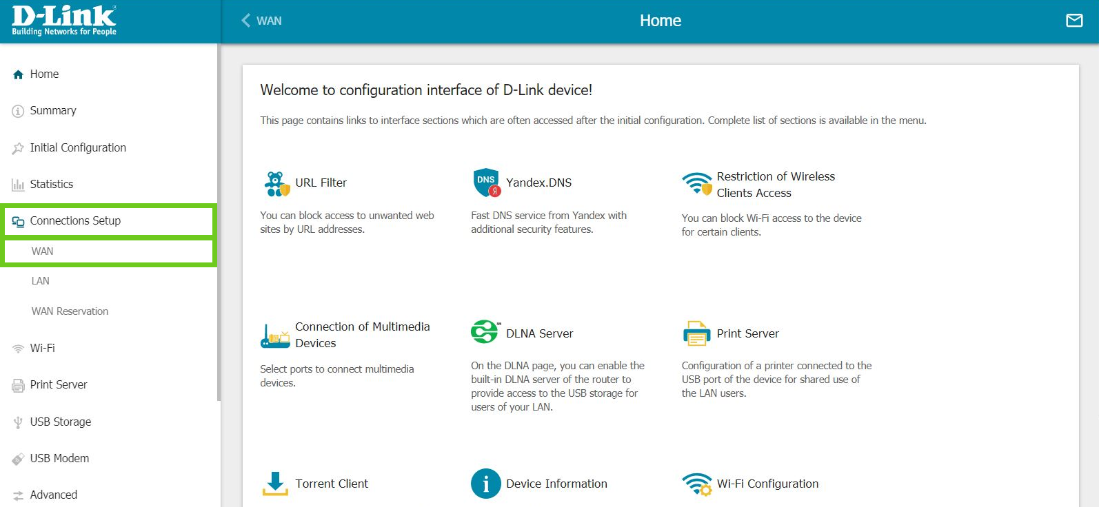

  • This will open the router's dashboard. Select ‘Connection Setup’ on the left and then select ‘WAN’ below that.

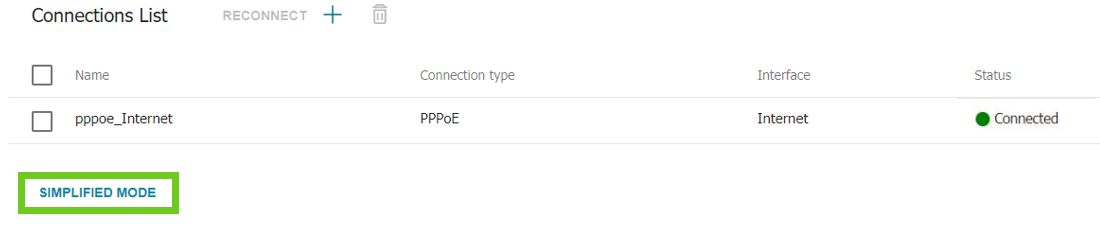

  • Select ‘SIMPLIFIED MODE', below the Connections List.

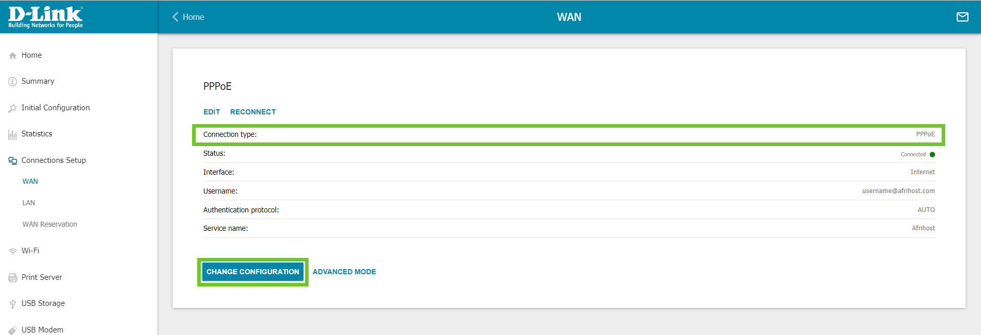

  • Here you will see the current connection types.
  • Select the ‘CHANGE CONFIGURATION’ button to change connection type.

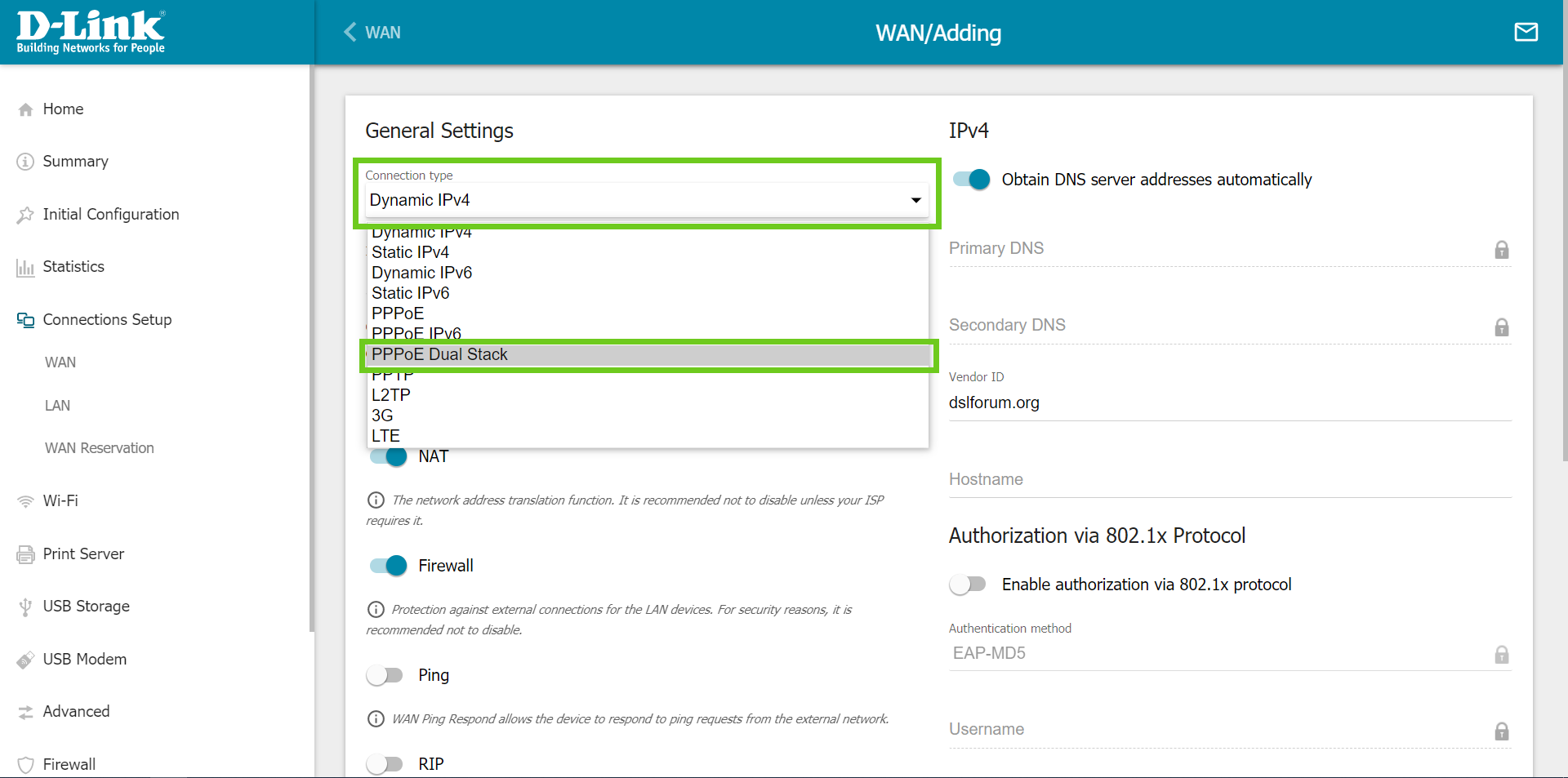

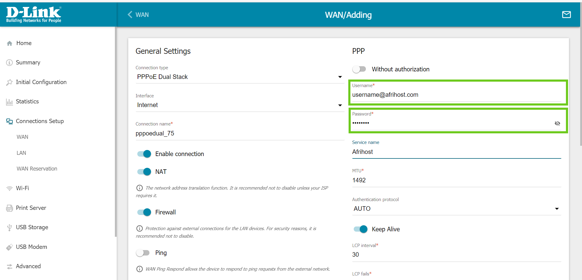

  • In General Settings, under Connection Type, select ‘PPPoE Dual Stack’ from the drop-down list.

  • Under PPP, enter your account PPPoE username and password.
  • Select your relevant Fibre package in the right-hand side.
  • Click on the ‘View Product’ button.
  • Your username is displayed at the top of the panel, below your package.
  • To get your password, click on the ‘Access Details’ button.
  • Click ‘Reset Password’.
  • In the success pop-up window, copy your newly generated password, save it and click ‘Okay’.

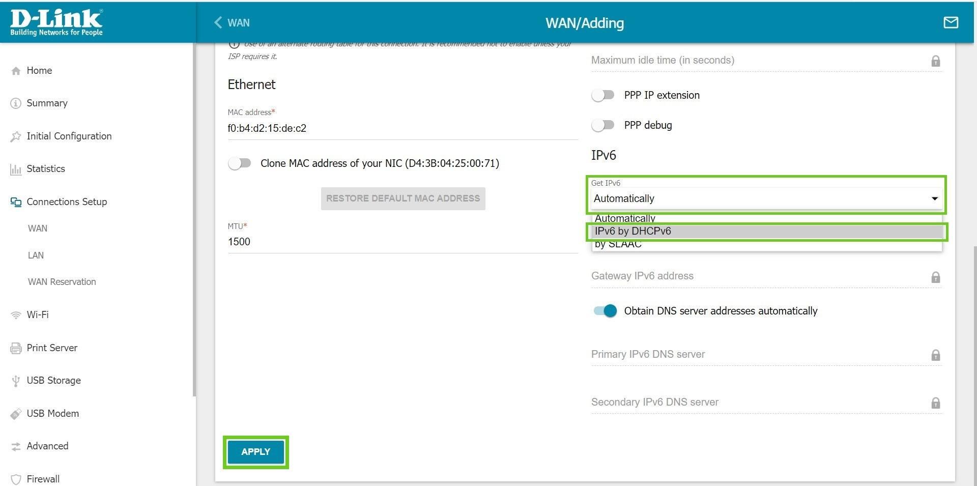

  • Under the 'IPV6 section' from the drop-down options under ‘Get IPv6’ select ‘IPv6 by DHCPv6’.
  • Click ‘Apply’.

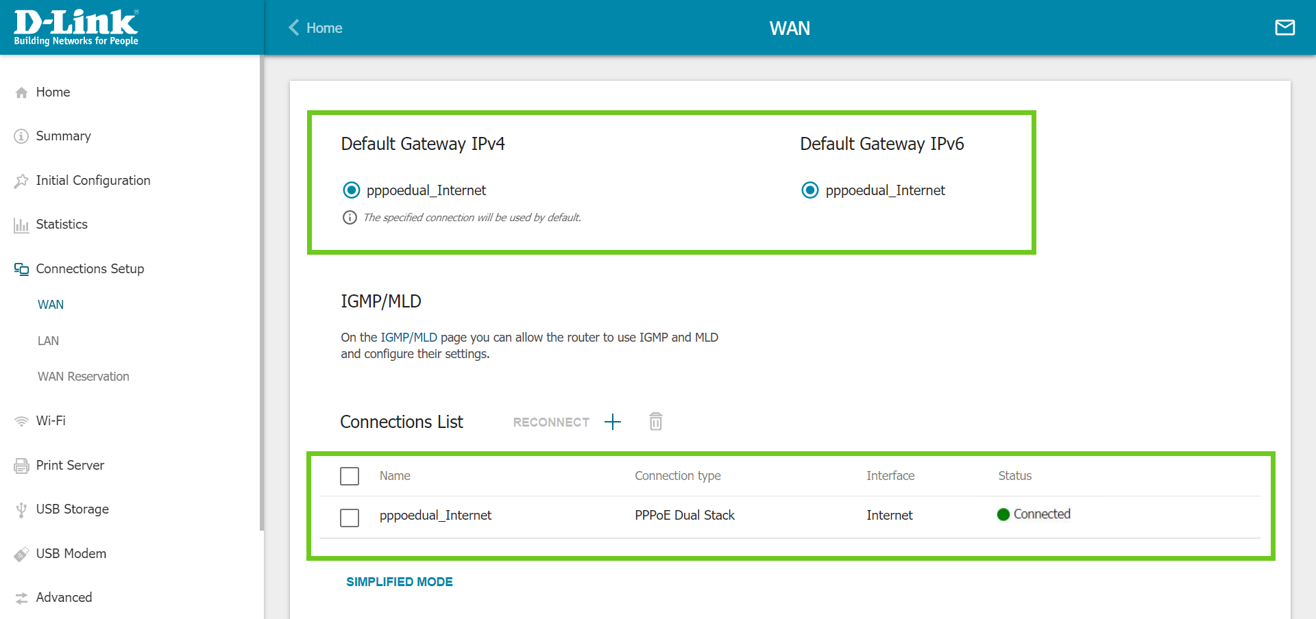

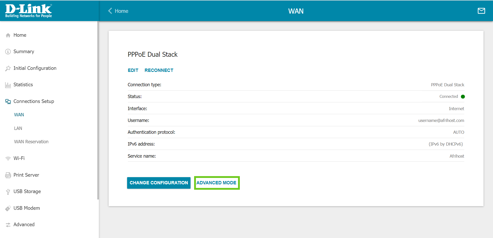

  • You will now see ‘PPPoE Dual stack’ information.
  • Select ‘ADVANCED MODE’ for detailed information.
  • On the connection list, you will see that connection type has been changed to ‘PPPoE Dual Stack’.

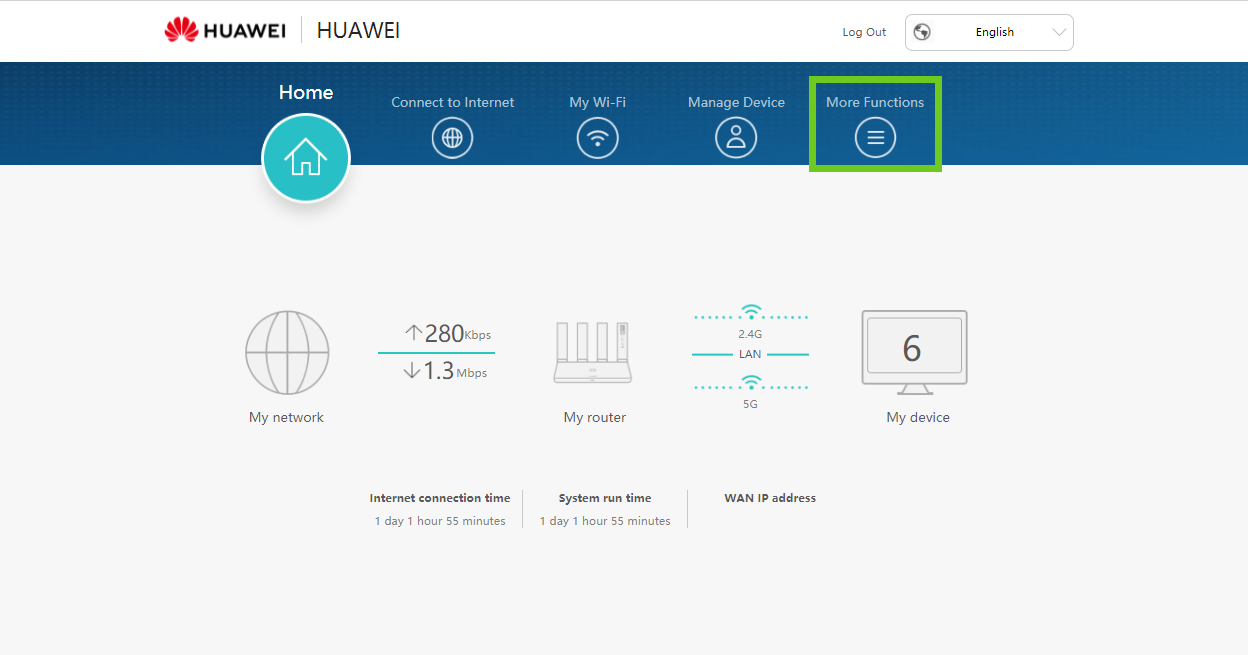

  • This will open the Huawei router’s dashboard.
  • Select the ‘More Functions’ button at the top menu.

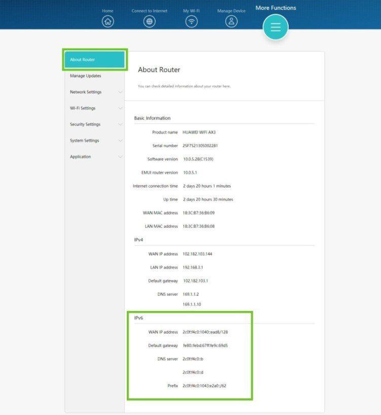

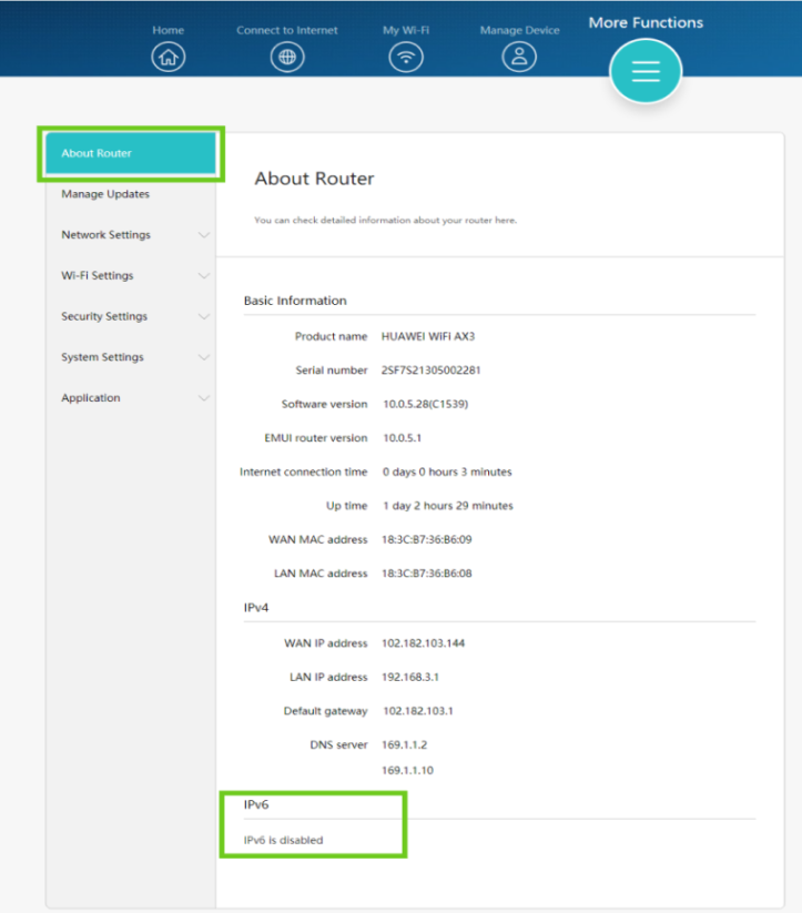

  • On the left panel select ‘About Router', scroll down to see the IPv6 status. It will probably be disabled.
  • If it is disabled, you will need to enable it.

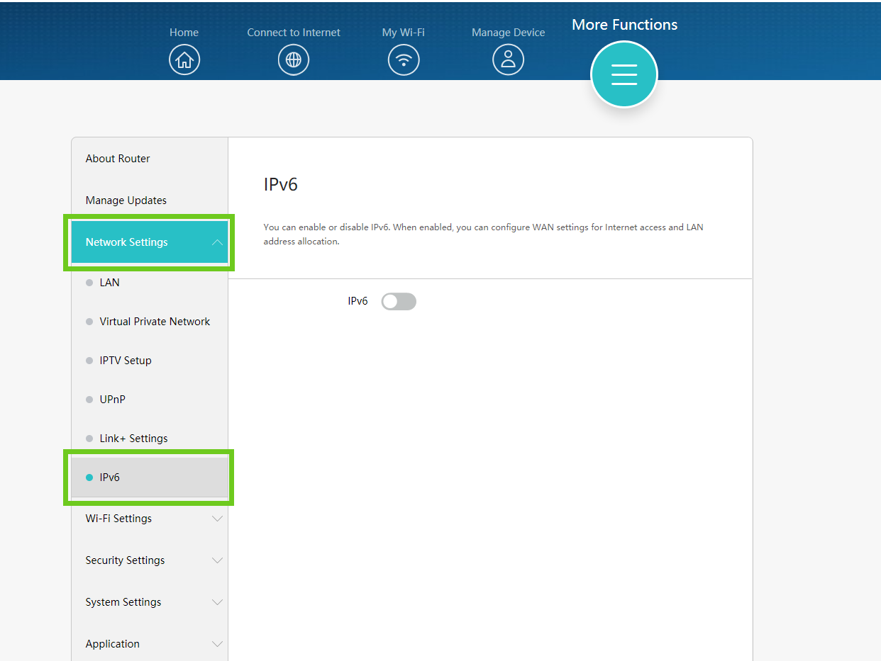

  • Select ‘Network Settings’ from the menu on the left-hand side.

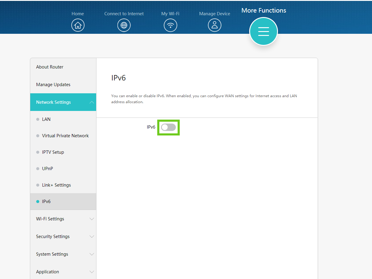

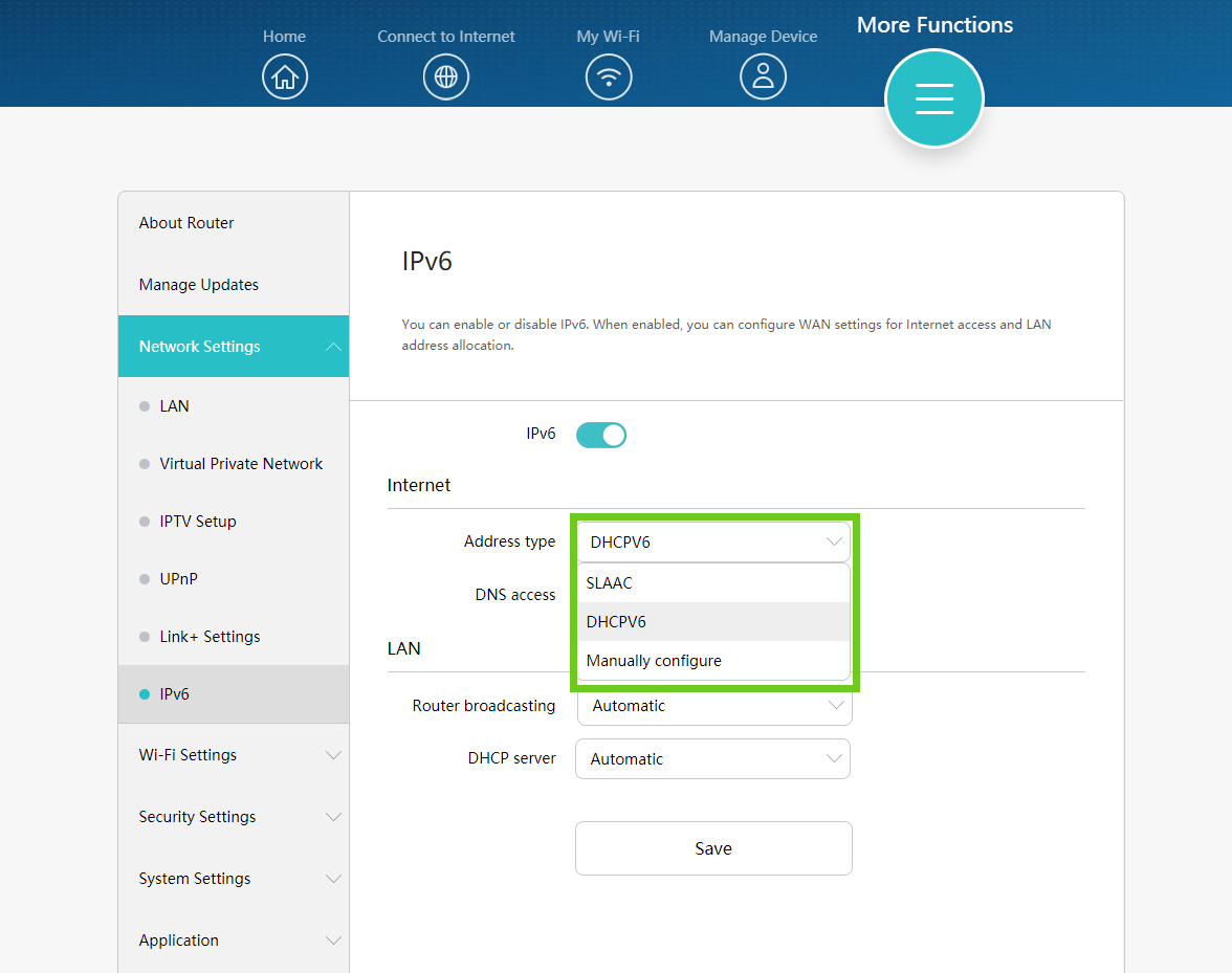

  • Under ‘Network Settings’, select ‘IPv6’ from the options below.

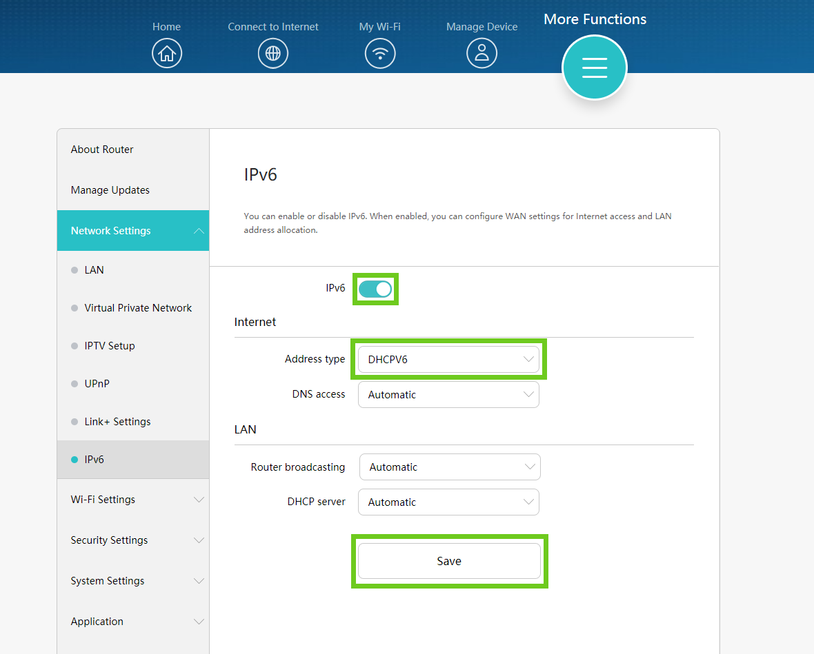

  • Enable the IPv6 toggle button.
  • Under Internet, change the address type to ‘DHCPV6’.
  • Scroll down and click ‘Save’.
  • You can go back to the ‘About Router’ page to check the IPv6 status.
  • The status will show the enabled IPv6 information.

Note!
Should the status read as below:
  • WAN IP address: ‘Unable to obtain’
  • Default gateway: ‘Unable to obtain’
  • DNS server: ‘Unable to obtain’
  • Prefix: ‘Unable to obtain’
You will have to perform a power cycle on your devices (Router and ONT).
