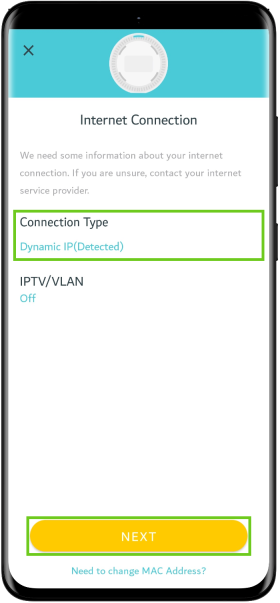

  • Connection Type: Select ‘Dynamic IP’.
  • Click ‘NEXT’.

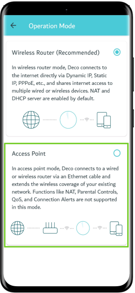

After the configuration is complete, the Deco unit will by default be in Router Mode. You will need to manually change it to ‘Access Point Mode’.

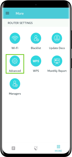

  • Select the menu button at the bottom right corner for more settings.
  • Select ‘Advanced’.

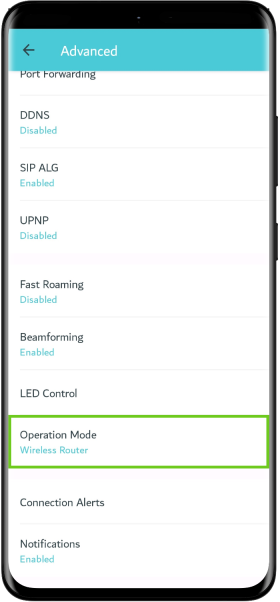

  • Scroll down to ‘Operation Mode’.
  • Select ‘Access Point’ as the operation mode.

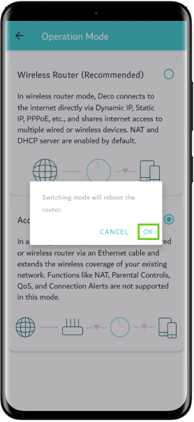

  • You’ll receive a prompt to restart your router.
  • Select ‘OK’.
  • Once the router has been restarted in the app, wait approximately 2 minutes until the light indicator of the Deco is solid green.
