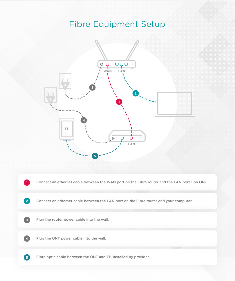

1. Set up your Fibre equipment.
After the CPE /ONT box is installed on your property, you will need to set up your fibre router equipment.
What is the CPE/ONT?
If you would like to know What is a Fibre ONT/ CPE and where should it be installed? read our Help Centre article for assistance.
  • Connect the ethernet cable from LAN Port 1 on the ONT device (The device installed by the fibre technicians) into the WAN/Internet port on your Afrihost fibre router.
    Ensure the CPE is powered up and lights are showing on the device.
  • Connect another ethernet cable from any of the LAN ports on your fibre router to your computer OR connect wirelessly to the router’s network (2.5 GHz or 5 GHz). The password can be found on a sticker underneath the router or on the welcome note found inside the box.
  • Plug the router power cable into the walls power supply.
  • The ethernet ‘LINK’ light must show on the ONT and the WAN light on your router. If these lights are present, it means that your fibre router is powered up correctly.
  • You will then be able to connect to the internet at 10Mbps for 2 hours in order to activate your fibre account.
